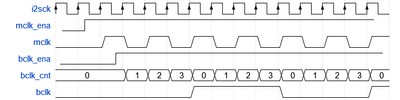

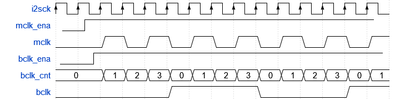

2024-09-10 11:01 AM - edited 2024-09-10 11:02 AM
versus
Note mclk_ena and bclk_ena which originate from the faster processor/AHB/APB clock (and are generated by the program writing the enable bits in the respective peripherals), which are faster and asynchronous to I2SCK. There may be a different delay between them in different runs, depending on the "there's too much other stuff still running". And voila, that results in different phase of mclk compared to bclk edge.
(In your case, bclk_cnt counts up to 128, but that's just a technicality, the point is the same).
(bclk = bit-clock = SCLK/SCK)
versus
