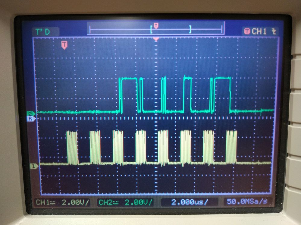

2017-08-16 12:35 AM
First of all, thanks for all replies and sorry for not answering earlier... i had a bank holiday and i couldn't continue with this...
I add more information related to this issue i am still having...
Here you can see the 8 bytes sent from slave to master (green), the clock signal (yellow) consist in 8 groups of 8 bits, this is what i m sending with :
HAL_SPI_TransmitReceive_DMA(&hspi6, (uint8_t*)HMI_slave_TX_data, (uint8_t*)HMI_slave_RX_data, 8);
uint8_t HMI_slave_TX_data[8]; this is buffer i use to send datas from slave to master.
As you can see in the image, according to green signal, the first 8 bits and the last 8 bits, the HMI_slave_TX_data[0] and HMI_slave_TX_data[7] values are 0x00.
This correct comunication is working each 100ms. Master send to slave the chip select signal, the clock signal and the MOSI signal each 100ms, and the slave send this MISO signal properly.

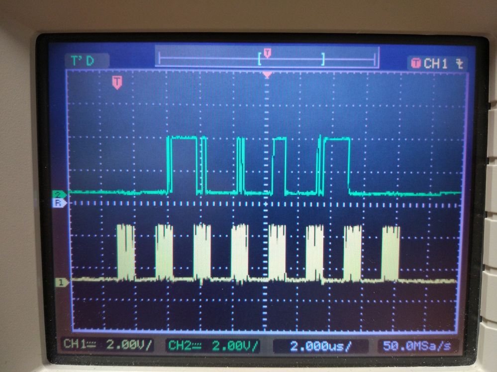

BUT after between 1min or 2 min randomly, the communication suddenly changed. The MISO signal is delayed as yo can see in the next capture:As you can see, the MISO signal should be exactly the same as prevous capture becasue HMI_slave_TX_data buffer is exactly the same all the time, but i dont understand why suddely the signal has being delayed to the next clock signal!! And as i mentioned, i checked the HMI_slave_TX_data buffer (using debug mode and also STM32 ST-LINK Utility in run mode) and the buffer was OK (only HMI_slave_TX_data[0] and HMI_slave_TX_data[7] values are 0x00), so in both captures the buffer is the same (it contains the same 8 values), but in the second capture is delayed or moved to left one byte!!
This wrong communication keeps all the time unless i reset the uC.
I am not 100% sure, but I thing it is related to the next function:
void HAL_SPI_ErrorCallback(SPI_HandleTypeDef *hspi)
{ if(hspi -> Instance == SPI6) { HAL_GPIO_WritePin(GPIOF, GPIO_PIN_1, GPIO_PIN_SET); memcpy((uint8_t*)HMI_slave_TX_data, (uint8_t*)HMI_slave_TX_working_buffer, 8); HAL_SPI_TransmitReceive_DMA(&hspi6, (uint8_t*)HMI_slave_TX_data, (uint8_t*)HMI_slave_RX_data, 8); //--- initiate HMI communication }}Becasue as soon as the comunication change from correct one to wrong mode, the GPIO F pin 1 is set. So i guess that it is due to this function or also due to a communication error this funtion is called... (this GPIO F pin 1 is set only in this part of the code).
I am not an expert on uC, and maybe i am doing something wrong, but from my pont of view, i think that the error is related to DMA synchronization...
Thanks in advance and best regards.
PD. sorry for a long email!
2017-08-16 12:51 AM
Apparently you don't have any explicit synchronisation mechanism between master and slave, relying on the fact that all 'packets' are 8 bytes long. But if the slave for some reasone misses a 'packet' it starts to transmit exactly like you've shown.
Best thing is eliminating the root cause.
Find out the reason why HAL_SPI_ErrorCallback() is called at all. I don't use Cube so I don't know what exactly this is, but if it's triggered by some of SPI states, read out the SPI status register at that moment. If you use a debugger, can do it by placing a breakpoint in that function and then observing the SPI registers (and, if needed, the DMA status registers too) in the debugger.
You may also want to see what has happened on the scope - if your scope has an 'external trigger' input, connect it to PF1 and set it to trigger on the edge on this input.

2017-08-16 3:46 AM
If the master continues to transmit, and the DMA is not circular, when you stop the slave's program execution in debugger (either manually or because the breakpoint is reached), the SPI continues to receive and eventually overflows.
