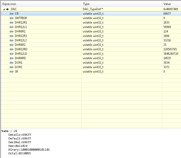

After the above init, this is in there
https://peter-ftp.co.uk/screenshots/202111264713675013.jpg

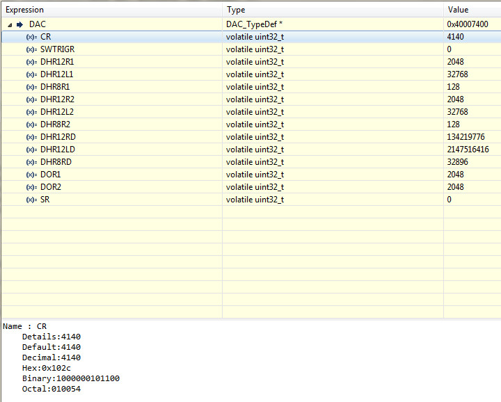

and after
DAC->CR = (1u << 12) // DMAEN1=1 - DAC1 DMA1 enabled
|(5u << 3) // TSEL1=5 - DAC1 trigger source Timer 4 (Timer 4 TRGO event)
|(1u << 2); // TEN1=1 - DAC1 trigger enabled
this is what is in there
https://peter-ftp.co.uk/screenshots/202111262013685213.jpg

2021-11-26 6:22 AM
You can copy/paste pictures here.
OK so the latter one:
is taken from the state when DMA works and generates varying output on both DAC1 and DAC2?
That's strange as DAC_CR=0x102c thus both DACs are disabled ...
