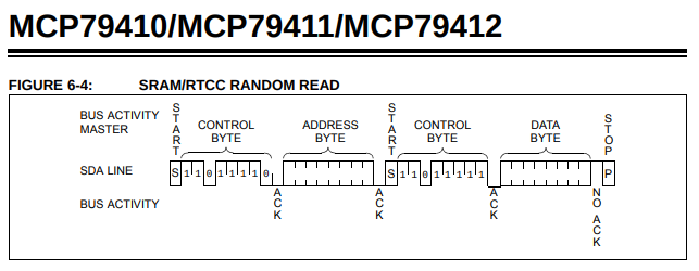

I need to use the MCP79410 rtc (or alikes: DS1307, PCF8583, etc) but the STM32CubeIDE I2C seems that can't handle the read/write protocol for these devices.
For example, as the below image shows, one needs to send the control byte (writing) followed by the address byte and, without emitting the stop signal, but a start instead, to send the control byte again, but for reading, and finally the stop signal:
I'm using the HAL_I2C_Master_Receive() function:
ret_val = HAL_I2C_Master_Receive( &hi2c2, 0x6f<<1, mytime, 3, 1000 );
It's obvious that this function alone can't handle the rtc protocol and my question is: which STM32 I2C HAL function, or function combination, should I use to comply with such protocol? Any ideas or an example?

Workaround:
Split the command into two operations. According to the Fig. 6.4 above:
1. Emmit a write command to set the reading start address (RTC, RAM or EEPROM), and of course, the device address (called "the control byte").
2. Emmit a read command to get as many bytes as needed.
