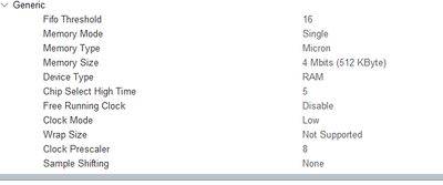

I think the problem was resolved. There's a "memory size" setting in CubeMX which had to be set to "512k / 4mbit" and then the thing begon sending data. Idk why...
For further reference, there was the fix.
