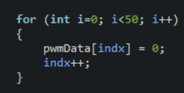

> the data doesn't get transmitted
Looks like your code sets everything to 0, or at least most of it (50/74 values) but we can't see the rest. The data looks like a bunch of 0's being transmitted.
