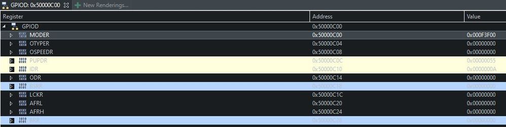

The pull-ups and other configuration related to GPIO seems to be OK.

LL_GPIO_Init(GPIOD, &GPIO_InitStruct);The peripheral clock is enabled for GPIOD. When seeing the RCC, GPIOD registers in the DEBUG everything seems correctly configured accordingly with the datasheet / Reference manual.
