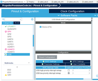

i´m trying to set up a communication via usb using the usb cdc class to communicate with additional software via a virtual com port running on a local pc using the Nucleo G474RE board.
However i can't find a sufficient documentation what i do have to implement / settings that have to be done to send and recieve data.
I`ve also watched the youtube tutorial from stm on the topic usb cdc but it didn't help me.
I made the following steps until now in the cube ide:

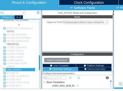

I´ve activated the usb in the communication section and the usb_device in the middleware where i also set the communication device class option.
Afterwards i solved the clock issue using the HSI48RC clock for usb.

Hi @j_ic
First, you can find in UM1734_STM32Cube.book the documentation for device library. Second, you can have a look a the following example STM32CubeG4/Projects/STM32G474E-EVAL/Applications/USB_Device/CDC_Standalone at master · STMicroelectronics/STM32CubeG4 (github.com) developed for the same chip on eval board. Maybe, your implementation is just missing clock recovery synchronization CRS.
