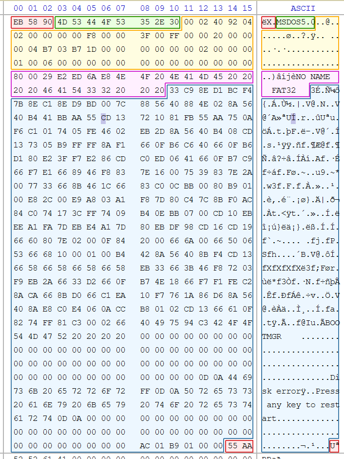

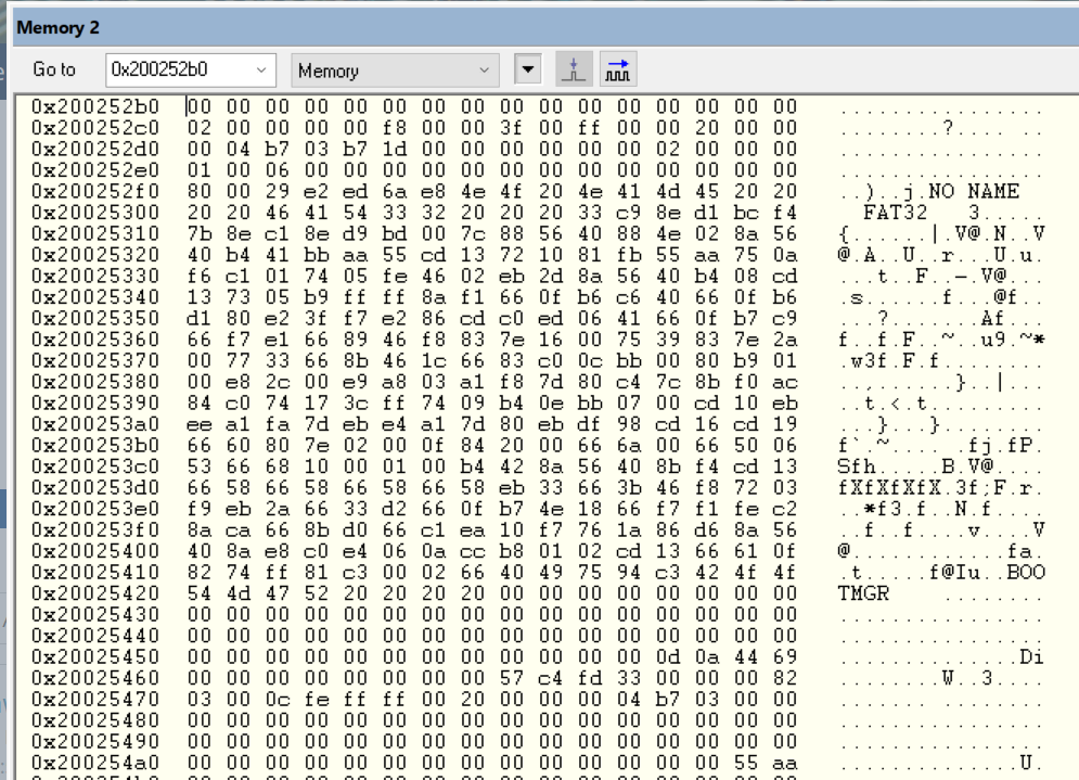

My ongoing difficulties running FATFS on an SD card has uncovered a problem! A read of the boot sector does not read all the data correctly, specifically the first 16 bytes are all zero. This means that FATFS reports there is no filesystem.
The code I'm running is all CubeMX HAL stuff, so I'm at a loss what the problem is. 16 bytes is 1 DMA burst, so that might be significant. Here are screenshots of the SD boot sector, firstly as read by my PC, secondly as read during f_mount() by my STM32F767.

2020-10-29 12:16 PM
See 16-bytes here as cache is on 32-byte boundaries, ie 0x200252A0, 0x200252C0, 0x200252E0..
This also gets to be VERY dangerous, as ByAddr variants of the DCache commands, as used by ST will have/cause collateral damage
