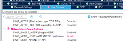

After migration to STMCubeIDE v1.19.0 and STMCubeMX v6.15.0 the working project based on STM32H7 Nucleo-144 Board (STM32H723ZGTx) shows red x for Pinout & Configuration caused by LWIP -> Key Options -> Network Interfaces Options with red x. This error blocks the code generation process.
Any suggestions?

Hover over the red X to find out the reason for the error.
Include the IOC here if you want someone to take a look.

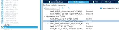

Change LWIP_NETIF_HOSTNAME to Enabled to get rid of the error.
After:
