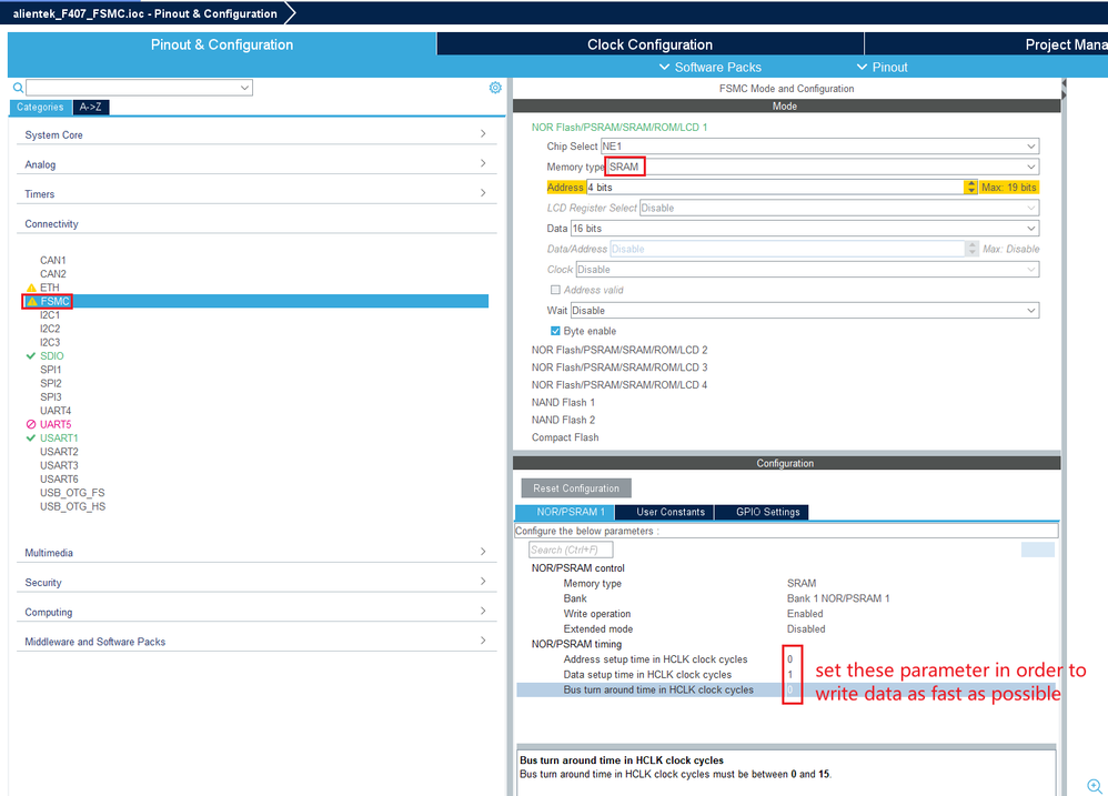

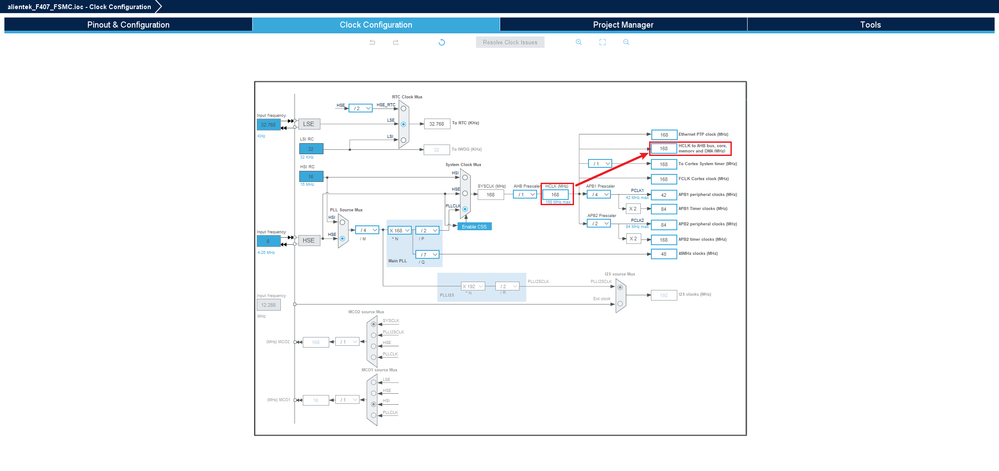

My goal is to send data as fast as possible so I set FMC clock to be maximum speed and set sram clock cycles to be as low as possibe.

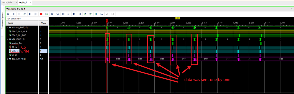

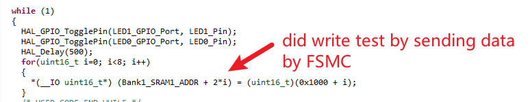

I use FPGA internal Logic Analyzer to capture data from FSMC and the result is shown as below.
I found that the data was sent one by one instead of burst mode(send data continuously) and the speed was well below requirement... I want to know how to use burst mode in FSMC?(Since I am using an FPGA to receive data so any mode is ok(PSRAM, SRAM, SDRAM, nano flash, etc))

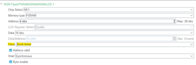

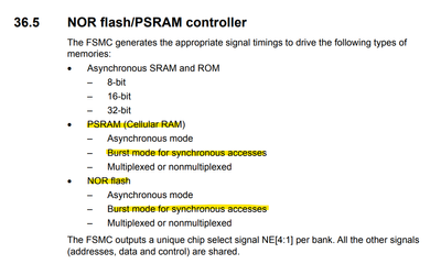

Hello @snkparty1;
According the reference manual RM0090 section "36.1 FSMC main features", the FMSC supports burst mode access to synchronous devices (NOR flash and PSRAM).
You can select a burst write in STM32CubeMX configuration.

2025-09-25 3:27 AM
Hello @snkparty1 ,
Apart what @KDJEM.1 said, and according to this thread and this thread: "I tried this on an STM32F429 and the test was successful" it seems you solved the issue. Could you please confirm? and provide the solution?
2025-09-25 6:45 AM
Sorry, I forgot this topic. Yes, PSRAM has burst mode. I accepted his answer as the solution. Thanks
