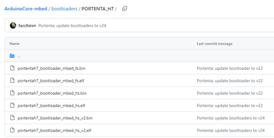

I don't know but I see that in the official github repo there are different versions that operate in USB FS or HS. https://github.com/arduino/ArduinoCore-mbed/tree/main/bootloaders/PORTENTA_H7

I grabbed the latest bootloader from GitHub and now my H7 is visible on a COM port! I used the Arduino IDE to write a multiple colored led blink sketch and it worked great. I then wrote that sketch and flashed it via the CubeIDE and it works great!
This is the good bootloader:
portentah7_bootloader_mbed_hs_v2.bin
It has an .elf equivalent but the CubeProgrammer couldn't flash it.
