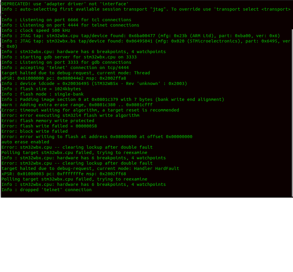

I am trying to flash code using openocd(through JTAG) in option byte RDP protection level is set to AA(0) but still openocd throwing error memory is write protected can not write on address 0x8000000.
Hardware : STM32WB55 Nucleo board
Openocd Version : 0.11
if anyone know the reason then please let me know.
Thanks in advance

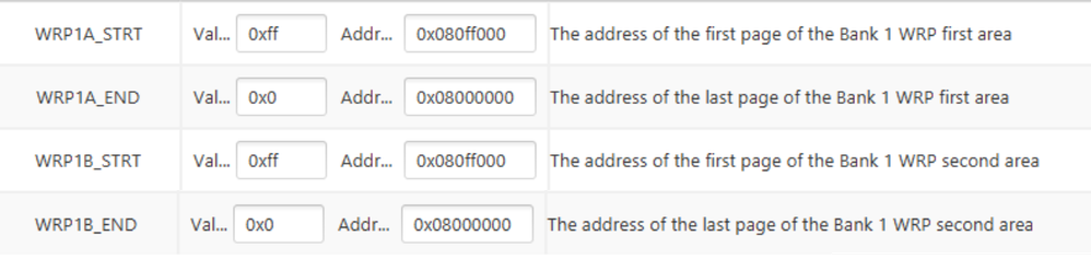

Dear @Pierre_Paris
I have uploaded photos of WRP1A and WRP1B start and end address values please let me know what's wrong with this value i have tried WRP1A_STRT = WRP1A_END and WRP1B_SART = WRP1B_END but still facing the same issues.
2023-10-30 2:04 AM - edited 2023-10-30 2:04 AM
Hello @DineshB ,
Here are some remark you can investigate :
Best Regards,
Pierre
2023-11-14 10:02 PM
Dear @Pierre_Paris
2023-11-20 2:33 AM
Hello @DineshB,
We can conclude there are no mechanism protecting STM32 flash, so the problem must come from somewhere else :
Best Regards,
