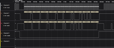

Inorder to analyse the problem , i am copying rx_buffer to tx_buffer in order to analyse better where snaps are attached below .

2023-11-18 12:23 AM
I'm unsure but I think that MOSI - Master Out Slave In is stored data correctly.
In image is start with 0x03 so that it get correct on.
So it's possible that master are do wrong.
another thing is I'm unsure what kind of this protocol. It's like as the MCU has free to exchange the data directly.
there is no any protocol as something like read or write command.
2023-11-18 12:35 AM
it is SPI communication . I programmed SPI Slave, i used External pin interrupt as chip select where it enables and disables the SPI slave and talk to master .
SPI data is not saving correctly in rx_buffer . 0x03 should be at the end of the rx_buffer
2023-11-18 1:55 AM
but from this image
it's start with 0x03.
2023-11-20 1:32 AM
Hi @Tinnagit ,
Channel 1 is MISO (it is the output from slave) .Here i am sending back the data which is received from master .
Thanks
