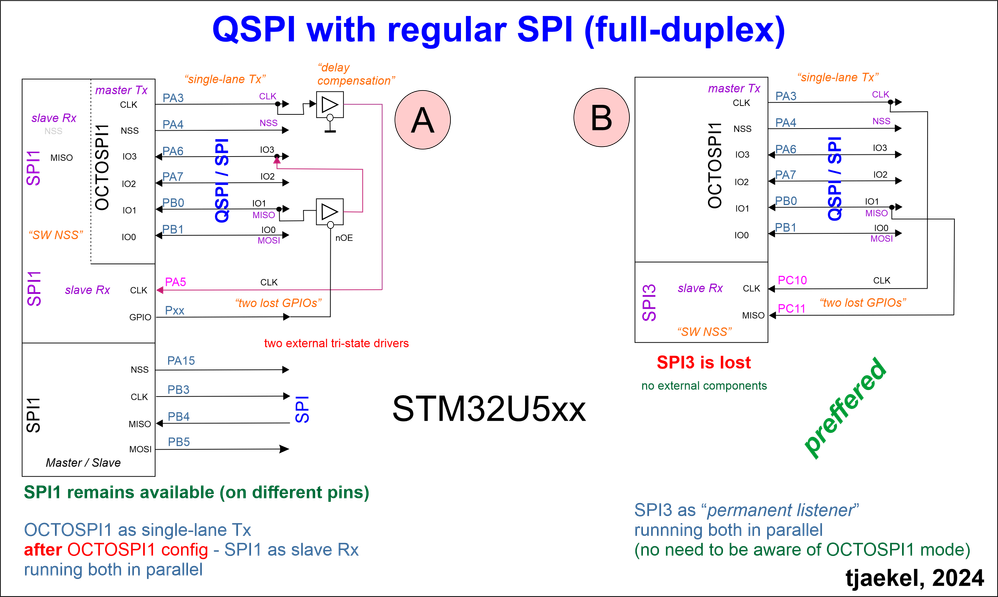

2024-01-20 1:25 PM
Due to "fact" that OCTOSPI is always a half-duplex device (even in single-SPI mode, better to call it "single-lane-SPI" - it is not a "regular full-duplex SPI" - here two HW options.
Intention: the OCTOSPI (used as QuadSPI) should reuse the same pins and signals to work also as a regular (full-duplex) SPI. So, I want to have:
Solution:
You lose two GPIO pins. Depending on the option - you lose entire SPI3 (option B).
With option A - the SPI1 remains available as a full regular SPI - just on different pins (with a different ALT setting).
Option A needs external components (tri-state drivers) and also some SW constraints:
Option B is easier, does not need external active components and is free of conflicts (SPI3 is always "listener", input). You just lose SPI3 as a regular SPI device.
Run OCTOSPI as master Tx and SPI as slave Rx in parallel (e.g. in INT mode or DMA mode, at least one device).
I go with option B.

2024-01-20 1:25 PM
Solution:
I go with option B.
