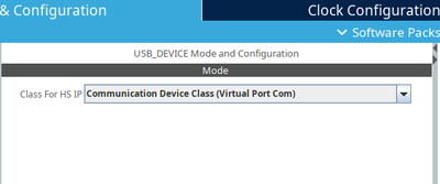

If you want it to do anything, you set it in Cube to the device , maybe it should be : CDC (serial com.)
and
+ check if for your board some jumpers or pins have to be set, to enable power on the USB,
and the USB interrupt enabled (in NVIC).
Then connecting to a PC should start enumeration and you get a "serial" in the system.
You did this ?

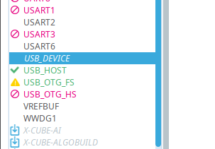

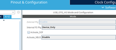

I've done the first pic, set Vbus internal fs phy. I don't know where you got the second pic from?
here...
Thats : decision ->  host or device
>second pic
...then set, what it should be/do : serial CDC , keyboard HID , storage ...etc.
Otherwise it cannot "guess" , what you expect.

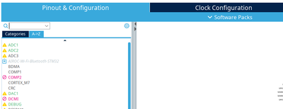

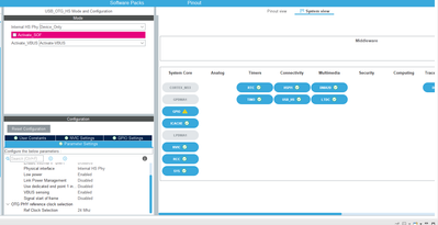

Hello
I have attached my clock ioc file and I can't find the USB_DEVICE option like the one you presented on your screenshot. Maybe I'm doing something wrong?
How did yiu ge the USB_Device part?
As always... :)
in IDE -> Cube -> pinout A-Z
you see host or device - what you set to be active - then choose, what it should do:
here OTG -->host  , then host --> MSC or other:
do same for device , what you want. (but device AND host same time dont work, so only one at a time is possible.)

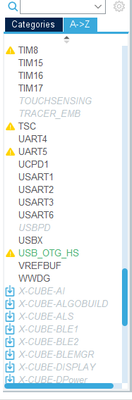

I'm still not getting USB_DEVICE, but USBX or USBPD
Aaa, now i understand (i dont have/tried U5G9 :( there is no (old) USB by STM .
So you have to copy/install it yourself, or try it with the USBX (from Azure):
there you can choose, which kind of USB device you want.
read
https://community.st.com/t5/stm32-mcus/how-to-implement-usbx-in-standalone-mode/ta-p/614435
