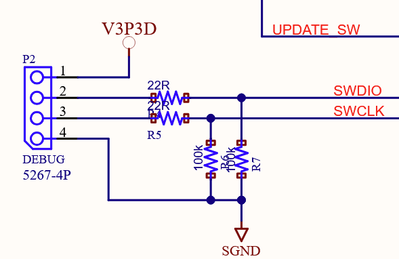

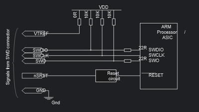

Do I need 22 resistance and 100k pull down for swd unconditionally?
I'm asking because I'm connected to a swd like this from another pcb I didn't make.
There's a saying in the search results that it's okay not to have it, and other articles use it in a pull-up form
<The swd circuit of the PCB I have>
<Searched Swd Circuit>

You can connect to the SWDIO/SWCLK pins directly. No resistors needed.
