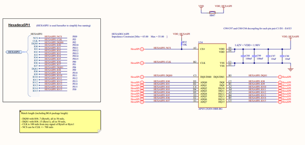

Hello @nwm_35 and welcome to the Community :),
Do you use the same STM32U5A9J-DK Altium_Designer project ?
Do you use the same line length and thickness as in the STM32U5A9J-DK Altium_Designer project to connect the PSRAM?
Could you please check the PSRAM pins?
Thank you.
Kaouthar
2023-12-05 11:31 AM
Kaouthar,
Thank you for your response. I went over our PCB with our hardware engineer. Our lines are all within 10mil of eachother so we're well below the 50mil requirement. What does byte0 and byte1 mean here though? Our clock is less than 100mils away from our data lines, but by looking at your stm32u5a9j-dk board your clock line also doesn't seem to be further than 100mil from data lines. So if byte0/byte1 aren't data lines what are they referring to?
We are not using your altium designer project because we use kiCAD but we've checked the psram pins against your schematic several times.
Please let me know what else you need from me.
2023-12-06 6:27 AM
Hi @nwm_35 ,
Byte0: DQS0, IO0, IO1,..,IO7 signals, these lines are match length with a maximum tolerance of 50mils.
Byte1: DQS1, IO8,..,I15 signals, these lines are match length with a maximum tolerance of 50mils.
CLK is 100 mils from any signal (DQS0, IO0, IO1,..,IO7, DQS1, IO8,..,I15).
Could you please try to decrease the HSPI frequency and let me know if the PSRAM issue is solved or not?
Thank you.
Kaouthar

We were able to achieve communication by increasing the prescaler in the BSP code for the stm32u5 to 2. This is fast enough to run a 480x800 screen at 16bpp and 28fps. However this is unable to support our other screen (720x1280, 16bpp, 52 fps). Our traces are packed too closely, and so we are working on a board revision that will allow higher frequency communication. We've copied the traces exactly as they appear on the stm32u5a9j-dk board. Do you have any specs on how much data we will be able to transfer over the hspi lanes when they are correctly laid out?
