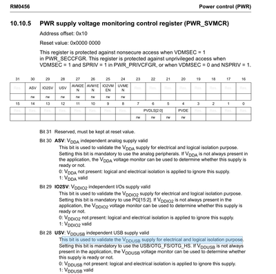

2024-04-10 8:45 PM
Thanks @SStor
Solved: Problem with Pin A11 on STM32U595VJ - STMicroelectronics Community
This method is effective.
SET_BIT(PWR->SVMCR, PWR_SVMCR_USV);
SET_BIT(PWR->VOSR, PWR_VOSR_USBPWREN | PWR_VOSR_VDD11USBDIS);

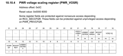

2024-02-05 4:00 AM - edited 2024-02-05 4:01 AM
Read out PWR_VOSR content and check those two bits in it. If they are not set, check if you've enabled clock for PWR in RCC.
If that's OK, read out and check GPIO registers content.
2024-02-05 10:35 PM
Thanks for your reply.I made a mini project to read the registers.The GPIOA register are ZERO...
The result like as:

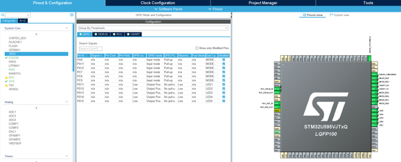

2024-02-06 1:21 AM - edited 2024-02-06 1:21 AM
I'd have a look also at GPIOA->MODER, whether both PA11 and PA12 are set as outputs.
Beyond that, sorry, I don't know what else to check.
2024-02-06 10:20 PM
Hi,my project is created by CubeMx.
The GPIO configured like as:
2024-04-10 8:45 PM
Thanks @SStor
2024-04-10 11:26 PM
Oh, an isolation switch... Thanks with coming back with the solution.
