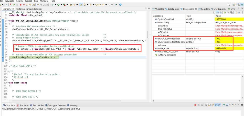

I am planning to do an aging test which need capture the voltage of a net, but i found STM32U585OIY6QTR report a value about 40 while the actual voltage of ADC channel is close to VREF.
Then i write a simple ADC demo to verify ADC configuration, and run my code on B-U585I-IOT02A board(based on STM32U585AII6Q), it report a correct value, but the same code report a wrong value on my board.I use ADC1 CHANNEL2(GPIOC GPIO_PIN_1) on both board.

We can read correct internal voltage value, so the ADC not broken.
But the converted VDDA is a strange value 9947mv.
What can we get from this phenomenon?
2026-03-17 8:27 PM
STM32U385 Vrefint=1.215V typ. I suppose you measure Vrefint channel and ADC result is 1979.
So, equation Vrefint / Vdda = ADC_result / 4096, then Vdda = Vrefint * 4096 / ADC_result = 1.215 * 4096 / 1979 = 2.515V.
Vdda=2.515V is in line with your board using 2.5V - ADC seems to work fine.

VREFINT_CAL: 14-bit raw data acquired by ADC1 at 30 °C (± 5 °C), VDDA = VREF+ = 3.0 V (± 10 mV), with Memory address 0x0BFA 07A5 - 0x0BFA 07A6.
maybe VREFINT_CAL is not correct, to be clarified.
2026-03-17 9:00 PM
Thanks your reply, after modify the formula, we get correct VDDA value.
