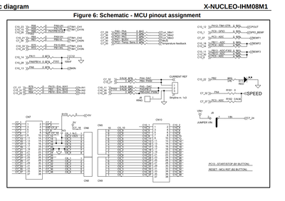

just ...maybe helping, if you would reveal which connections you talk about:
2025-10-27 4:23 AM
Hi AScha.3,
Thank you for your reply. I am seeking help with all ADCs, the specifc one I am referring to is for voltage bus measurements, configured on pin PA1. It is located in the top middle portion of the image you sent me. Attached is the assisting circuitry for the input.
Thank you for your help.

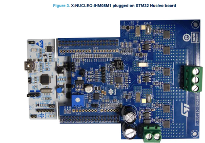

2025-10-27 5:26 AM
how did you connect to the H7 board ? (because its for morpho connector on nucleo64 boards fitted.)
2025-10-27 5:37 AM

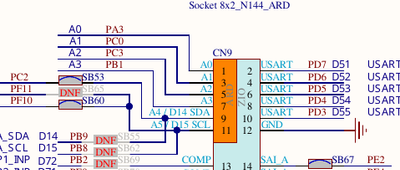

2025-10-27 6:07 AM - edited 2025-10-27 6:25 AM
Ok,
so assuming you did it correct:
...seems, your "A1" is then PC0 on the H7 /144 board. Try this as the analog Vin.
see in circuit...and check on which pins you come out on this board !
https://www.st.com/resource/en/schematic_pack/mb1364-h723zg-e01_schematic.pdf
2025-10-27 12:20 PM
2025-10-27 10:49 PM
Hi AScha.3,
With the help of the schematic you linked I was able to realise that SB57 needed to be removed. PA1 now works correctly but I am still having some issues with the pins used for current sensing. I have configured them on PA0, PC0, and PC1 for phases U, V, and W respectively. If you have any insight as to what might be wrong I would greatly appreciate your assistance.
