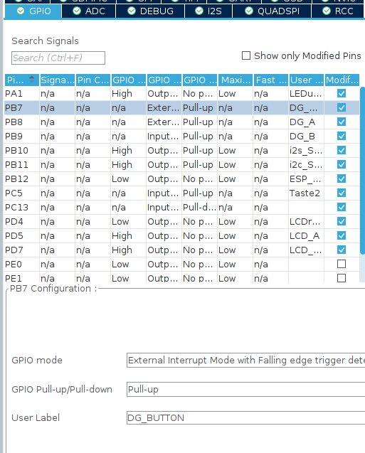

But using the TIM1 configured to 100[khz] (>88[khz)), and to generate TIM1 Capture Compare interrupt, it seems to fail to count the pulses correctly: it either calculate less or more (for example: room temperature 25 [Celsius] we get either ~800 or ~1500 pulses, instead of ~1200). Also configured are four channels of TIM1 (please see attached all configuration done in STM32CubeIDE - just missing from the snapshot is settings we did to achieve 100[khz] of TIM1: Prescaler set to 64-1, Counter Period (ARR) set to 10-1, according to the formula: Timer frequency = (timer clock frequency) / (prescaler x auto) and HCLK is 64[Mhz].
