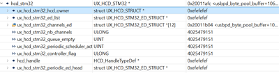

Hi, don´t know why, but when I started debugging again this morning, the interrupt was fired. But then in void HAL_HCD_Connect_Callback(HCD_HandleTypeDef *hhcd) I get a hard fault in this call: hcd_stm32 = (UX_HCD_STM32*)hcd -> ux_hcd_controller_hardware;
After this hard fault hcd_stm32 has the following content:
