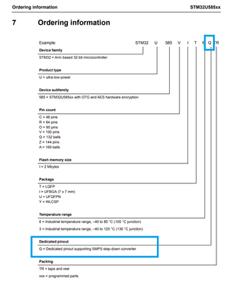

I didn't understand why are you switching between the modes between LDO and the SMPS in STM32U575 product.
There is only one power configuration according to the package (SMPS or LDO):
This is not STM32H7 having the two power configurations.

You are very wrong. The STM32U575VIT6Q has both the LDO and SMPS. After reset the LDO is enabled. The SMPS has to be enabled explicitly. There is even an example program for the STM32U575 developer board that allows you to switch between the two regulators to measure power consumption. As you are an employee of ST, I would expect that you would check the data sheet before giving a very wrong answer. The power consumption using the SMPS is about half of the LDO consumption.
2025-02-11 1:47 PM
Ok you are correct but as a "ST employee" I could be wrong and I'm not expert of evreything as well as all of the products.
