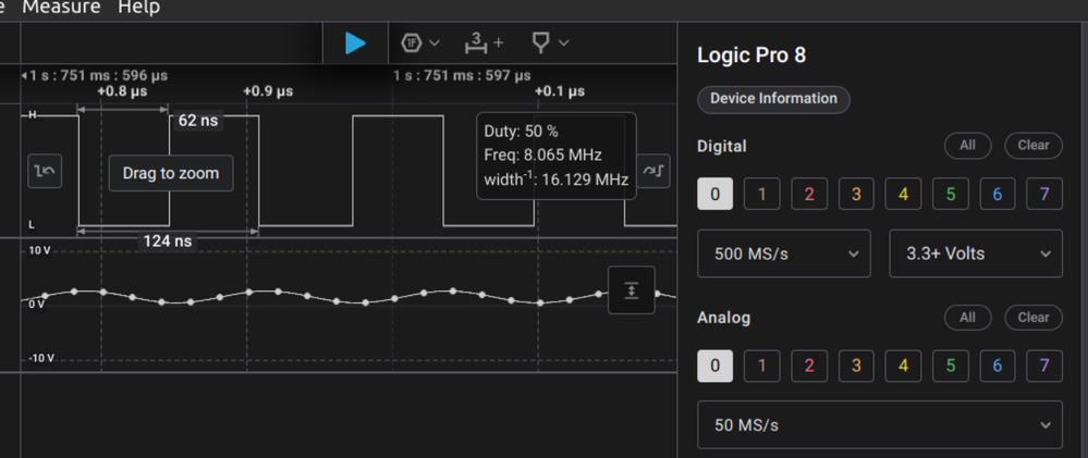

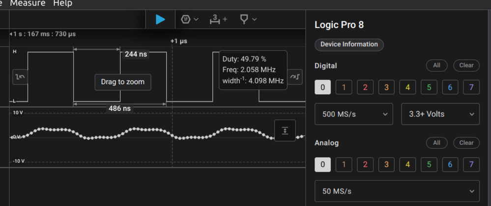

2024-08-22 10:39 PM - edited 2024-08-22 11:05 PM
I just toggled a GPIO on my U575 NUCLEO with GPIO Speed set to Very High
calling HAL_GPIO_TOGGLE = ~ 4 MHZ
calling GPIOF->ODR ^= GPIO_PIN_13 = ~ 16 MHZ

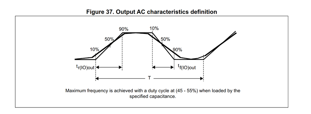

I would also suggest reading the electrical characteristics for the IO ports for your chip in the Datasheet (not the RM)
Eventually there will be a section on output frequency based on, like the previous answer said, load capacitance
