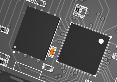

Check VCAP parts actually placed.

VCAP capacitor is close to MCU :

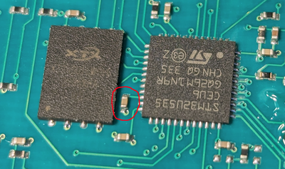

On the actual board, it is present :
Thanks to your hint, I discovered that this capacitor is 10 µF while datasheet says 4.7 µF.
Changed to 4.7 µF and voilà ! MCU is now running fine at 160 MHz ! \o/
Thanks a lot !
I would rather suspect a cold joint corrected as a side effect of your fixes. Usually, but not always, bigger capacitance is better in these places.
