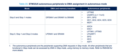

To use SPI3 in autonomous peripheral, it is necessary to use LPDMA regardless of the stop mode used, as SPI3 is not supported with GPDMA. You can refer to Application AN5371 specifically Table 46. STM32U5 autonomous peripherals to DMA assignment in autonomous mode.
