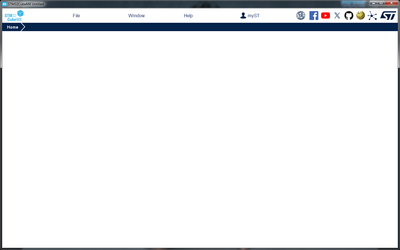

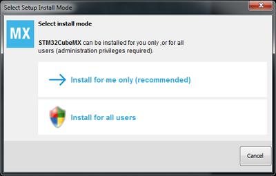

Had an installation of CubeMX v6.9.2 on Windows 7 without any logins and upgraded it to v6.10.0 with "Install for all users". After the installation, this stayed open and neither the X (Close), nor the Cancel worked - those just do nothing. For Cancel even the hoovering doesn't work - none of the button colors changes.
Now for the CubeMX itself. None of these work at all - again clicking just does nothing:
  • Help => Check for Updates
  • Help => Manage embedded software packages
  • myST => Login
  • Opening IOC files, which were saved by a previous versions, any way from a CubeMX GUI.
Opening IOC files, which were saved by a previous versions, by a double-click in Windows Explorer leads to this:
Running it with "Run as administrator" - the same result. Installed "for me only" - the same. Uninstalled it, removed all of it's files, installed v6.10.0 fresh - still the same result.
A fantastically "enjoyable cohesive experience"!

The fact, that the whole home screen is blank in my screenshot, suggests it could also be a web page, though a local one. I guess showing the 6 marketing/info images on the lower right corner was too hard for them to implement in Java...
But those are just my educated guesses.

By the way, it is true that the installer of STM32CubeMX has been changed in 6.10.0: now it asks for private or shared installation, which gets rid of the administration rights if you choose the first one.
But unfortunately it is only available for Windows OS !

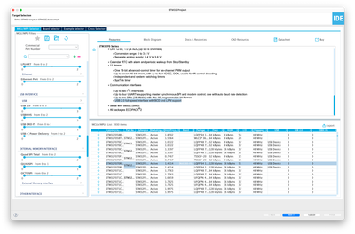

In STM32CubeMX 6.10.0 it is impossible to use sliders in order to filter out USB2.0 FS capable MCUs.
See screenshot.
- STM32F070RB has USB 2.0 FS
- there is no way to use filters (sliders) to pick out USB FS devices as all USB related numeric data fields for this MCU equals 0
-  only option to get USB FS MCUs at a glance is to enable USB column and sort by that

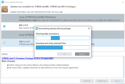

Senior II
When trying to update Cube MX as per instructions at top of thread, I get through the download installation screen. All running as Admin.
It prompts me to restart. I restart, running as Administrator and I get the following message with the update failing.
Pressing Retry doesn't work. Can anyone from ST please advise?
