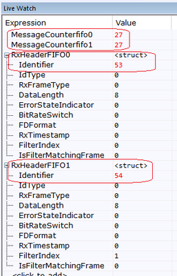

And here is the live watch of IAR showing the headers updated with the IDs in both callbacks FIFO0 and FIFO1:

As you are using standard ID, please increase the number of standard ID filters: hfdcan1.Init.StdFiltersNbr > 1
