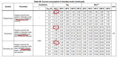

2024-05-14 7:41 AM
And note from the datasheet:
It really seems possible that only the BKSUPSRAM is enabled and not the 8kB or more in the SRAM2.
But, this would mean:
- The comment in the RM is confusing
- The PWR_ModesSelection example is confusing
Anyway, I'd like to hear from you what the actual supported options are.
Kind regards,
Arnout
