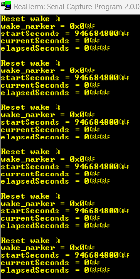

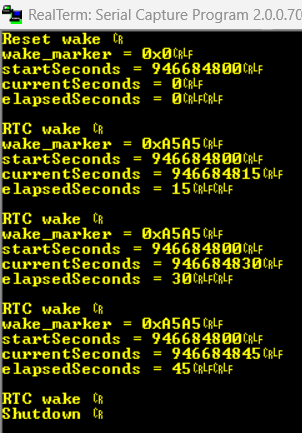

Everything works correctly in debug/run mode, but when there is a cold reset (power loss) the shutdown after 60 seconds does not work. It just cycles through 10 second wake, 5 second sleep etc.
UPDATE 2:
I modified the code in main (including the version in this post) to send the data over UART for debugging.
I send the values of startSeconds, currentSeconds, elapsedSeconds and whether the wakeup source was RTC, WKUP pin or reset.
I can see after a cold reset that the RTC backup is always zero, so it always thinks its waking up from reset.
Why does the RTC back work in debug/run mode, but not in standalone after a cold reset ?
In debug/run mode the terminal result is:
After cold reset the terminal result is:

uint32_t tmp = HAL_RTCEx_BKUPRead(&hrtc, RTC_BKP_DR3); // restore power switch state from RTC backup register
powerSeq = *(uint8_t*)&tmp;
// check if elapsed time is greater then shutdown time
if (elapsedSeconds >= RTC_SHUTDOWN_S)
mcuPowerdown();
else if (wake_marker == WAKE_FROM_SHUTDOWN_WKUP)
// woken from shutdown (power switch pressed during shutdown)
wakeConfigReset(); // reset time and date and set default reference pressure
else
// woken from reset
// store value in RTC backup register to indicate mcu was reset
HAL_RTCEx_BKUPWrite(&hrtc, RTC_BKP_DR2, WAKE_FROM_RESET);
ChatGPT explained the reasoning behind the behaviou....
In debug or run mode (e.g. via ST-Link or when powered via USB), the power is never fully removed — so:
Certain power control and backup domain registers (like PWR->CSR and RTC backup regs) may retain their values.
The SB flag can remain set, giving the impression it survived SHUTDOWN.
Why it fails in standalone after a cold reset:
In SHUTDOWN mode, only the RTC and backup domain are retained via VBAT.
However, on most STM32s:
The SB flag does not survive SHUTDOWN (it's not designed to — unlike in STANDBY mode).
After a cold power cycle, everything except what’s powered by VBAT is reset — including that flag.
Hence, __HAL_PWR_GET_FLAG(PWR_FLAG_SB) returns false.
TL;DR
PWR_FLAG_SB is only valid for detecting wake from STANDBY, not SHUTDOWN.
It might "appear" to work in debug due to partial power retention or debugger interference — but it's not reliable.
Always use backup register markers or the RTC time to infer wake source across SHUTDOWN.
