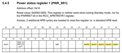

2025-08-08 12:55 PM
The pin needs to be initialized as an input pin before HAL_GPIO_ReadPin will read its state. By default, the pin is in analog mode.
If a wakeup pin caused the wake up, a flag is set in RCC->SR1. This is latching--it doesn't reflect current state of the pin.
2025-08-08 1:12 PM
Thanks TDK
How do I read the RCC->SR1 register ? Is there a macro or function ?
2025-08-08 3:46 PM
You can just read it and look for the corresponding bit:
if (RCC->SR1 & RCC_SR1_WUF1) {
Or you can use the READ_REG macro:
if (READ_REG(RCC->SR1, RCC_SR1_WUF1)) {
Of if you prefer HAL:
if (__HAL_PWR_GET_FLAG(PWR_FLAG_WUF1)) {
All equivalent.
