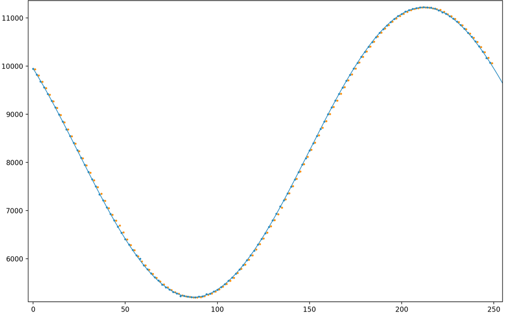

ARR: 000004FFI've also included a screenshot of what I am seeing from my ADC samples. This is measuring a 1 kHz sine wave at 250 ksps, reading channel 15 twice in each sequence (as configured in the registers above), for a duration of 1 ms. So, there are 250 samples total, with 125 of them for the first channel in the sequence and the other 125 for the second channel in the sequence (again, both of which are channel 15).
In the graph, the X coordinates are increasing with sample number (sample 0 is the first conversion from sequence 0, sample 1 is the second conversion from sequence 0, sample 2 is the first conversion from sequence 1, etc...). My expectation was that all points would lie on the sine wave which would be the case if the second sample in the sequence was waiting for my TIM trigger. Instead, it is clear that the second sample is being taken very soon after the first sample in each sequence. Note that there is some noise in my hardware which is a Nucleo board and a bunch of jumpers that are not well shielded, but the samples from 150-250 are pretty clean here and show the problem clearly.
I am going to try using SMPTRIG to do this measurement instead of bulb mode and see if that helps.

I should add that I am using the offset register to subtract out 0x2000 and make the values signed; in my plotting tool I am adding the offset back in which is why all the ADC values are positive and not straddling the X-axis.
