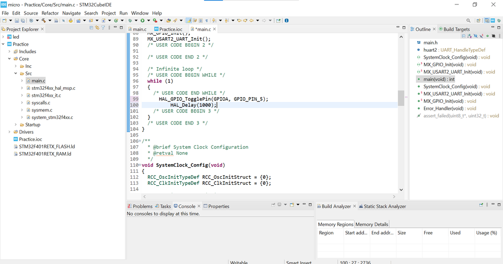

Hello, I have had a problem and it is that I make a simple program, in this case the blinking of the led of the "NUCLEO-F401RE" board and I use the gpio that comes by default. The point is that when I try to debug main.c, another file is opened (which is inside the same Src, called stm32f4xx_it.c) and that file is debugged and not main.c, which file has nothing .

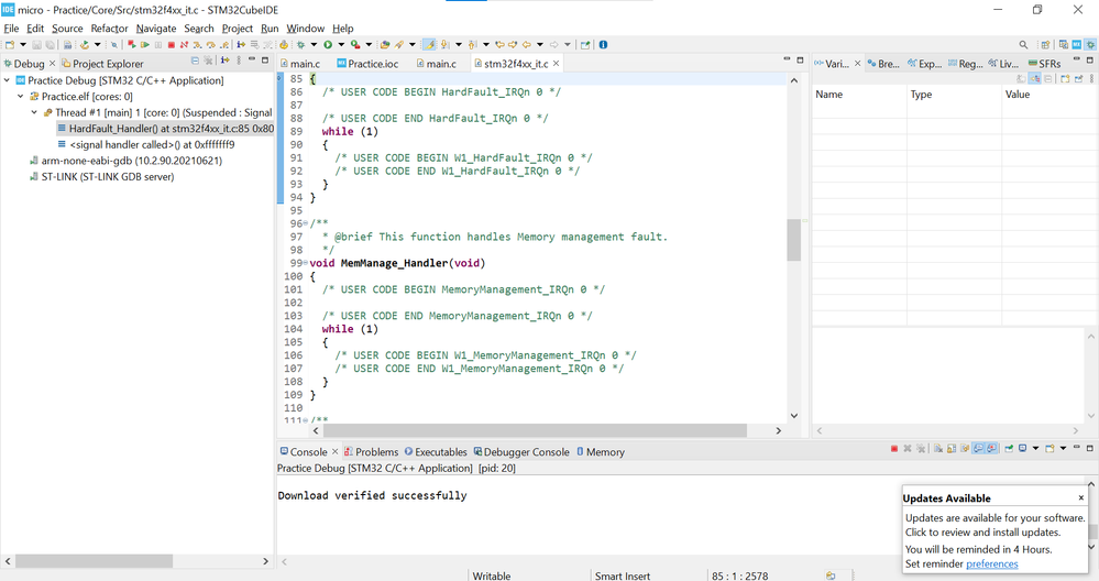

show us where in the stm32f4xx_it-c does your debugger stop, maybe in the hardfault handler?

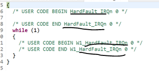

2023-02-09 6:50 AM
That is the hardfault handler.
It means something went very wrong in your code

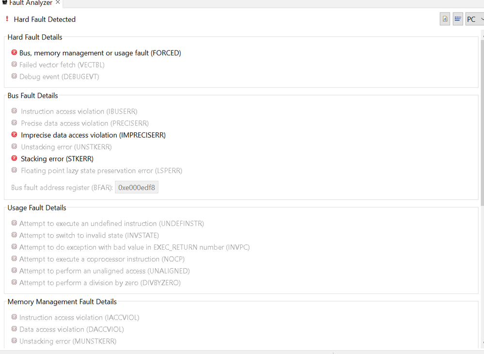

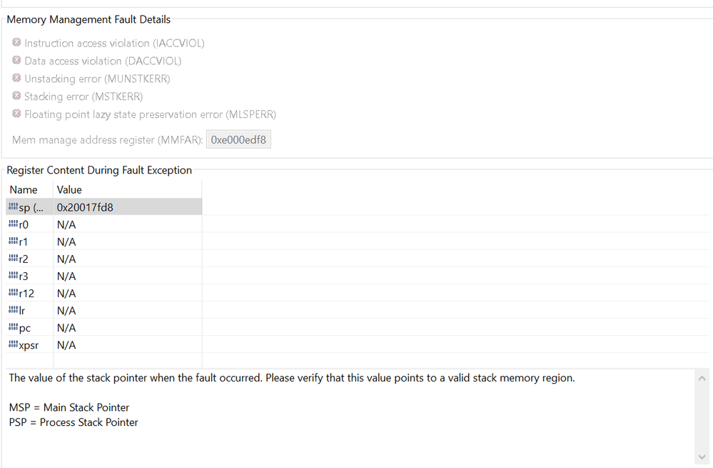

I checked the Faul analyzer and this is what it gives me:
You can already see that the problem is indicating it to me but I don't know what to do to solve it.

also i believe "GPIO_PIN_5" is not defined anywhere , you just tried your luck there. try this: (after looking in "main.h" defines)
Instead of
HAL_GPIO_TogglePin(GPIOA, GPIO_PIN_5);do
HAL_GPIO_TogglePin(LD2_GPIO_Port , LD2_Pin );
2023-02-10 12:28 PM
I have declared PA5 in the visual part, but even so, I tried what you suggested and still, the error enters.
