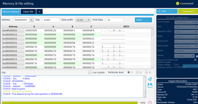

This is screen of STMcubeprogrammer:
After checking with debugger, after the bootlaoder "GO command" the program flow gets to main.c(set breakpoint at HAL_Init(); ), so there is some other problem with main APP not really working. Thank for your help.
