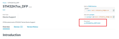

If KEIL used, did you already installed the H7 pack? from: https://www.keil.arm.com/packs/stm32h7xx_dfp-keil/overview/
