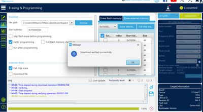

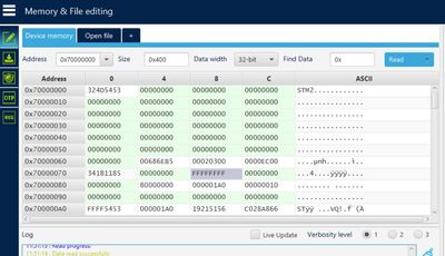

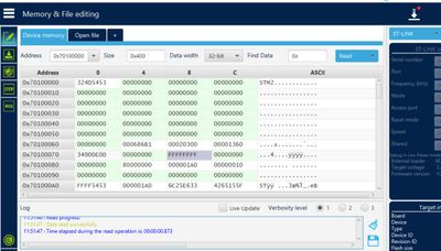

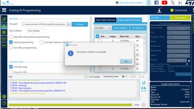

I have created a custom external memory loader for W25Q32JWZPIQ and able to connect device in Dev boot mode (BOOT1 -1, BOOT0-0) and flash FSBL-trusted.bin and Appli-trusted.bin at 0x70000000 and 0x70100000 respectively. Also, I am able to verify the contents.

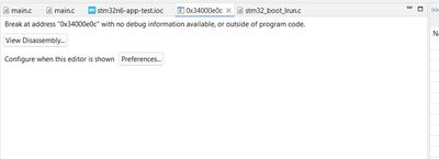

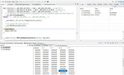

I tried to debug by setting device into Dev mode and run FSBL directly into internal RAM, I can see the FSBL is properly copying the application code to 0x34000000 but JumpToApp() ends up in fault.

FSBL-trusted + Appli-trusted(Led toggle) + ExtMemLoader - FSBL and Appli loads into internal RAM but crashes at JumpToApp().
