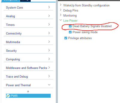

You can call HAL_PWREx_DisableUCPDDeadBattery(), write the registers directly or there is actually a checkbox in the IDE that would saved me hours of investigating ;)

I have had a problem on STM32H562 with PB14 (UCPD1_CC2 - FT_c) configured as an open drain output.
the output was not always at the correct level and switching erratically somehow related to QSPI access.
calling HAL_PWREx_DisableUCPDDeadBattery() has fixed the problem.
this from the HAL drivers should really be made more clear and explicit elsewhere?
