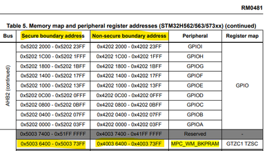

You can refer to Table 5. Memory map and peripheral register boundary addresses (STM32H562/563/573xx) in RM0481 Rev 4: to find adresses:
Non-secure boundary address :0x4003 6400 - 0x4003 73FF
Secure boundary address: 0x5003 6400 - 0x5003 73FF

2026-02-04 12:23 AM - edited 2026-02-04 12:27 AM
From RM0481, Table 6. Memory map and peripheral register addresses

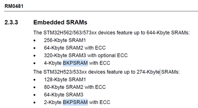

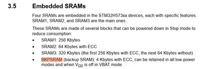

2026-02-04 12:27 AM
Yes, this answers my question. Thank you!
The confusion was mainly due to naming: I was searching for BKPSRAM, while in this context it is referred to as BKPRAM. That’s why I couldn’t find it initially.
