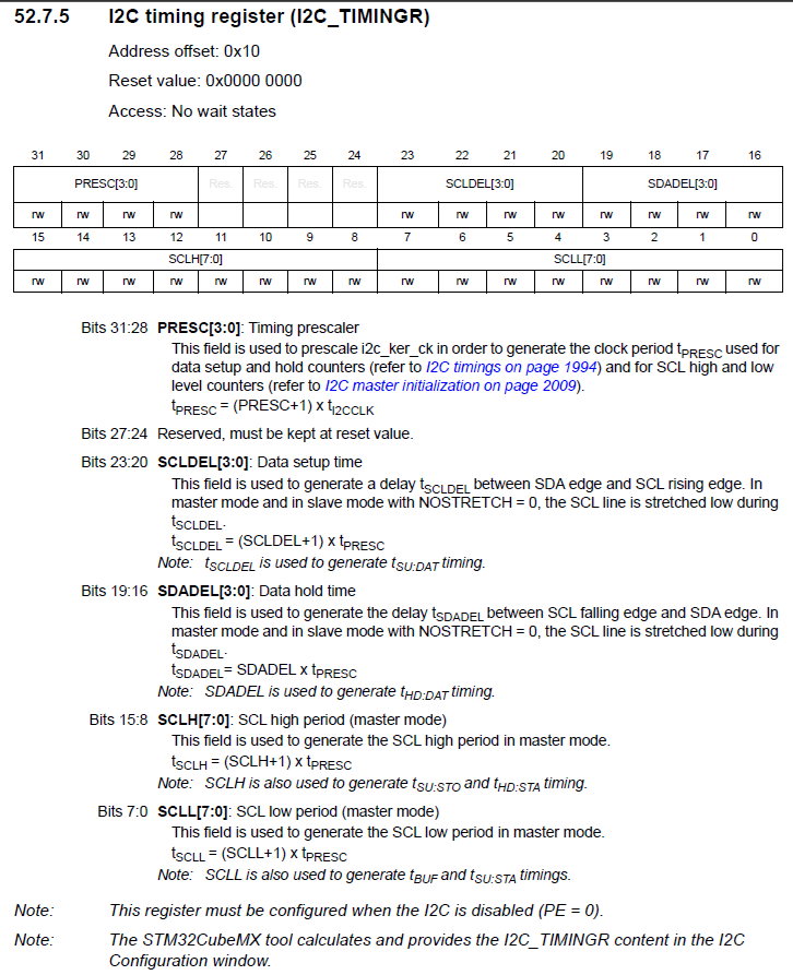

Yes. I had the same experience with the timings generated by STM32CubeMX, so I normaly use the possibility to set my own timing (by enabeling Custom Timing).
You can start by using the values CubeMX has calculated and modify them for your use case. The hex value in Timing is the value writen to the I2C timing register, I normaly change only the two low bytes (SCLH and SCLL).

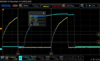

Communication to I2C devices are working in this design, but I wonder about two things, which seems to relate:
1. Normally you will with I2C have relatively piece wise equal on/off clock timing (yellow trace in scope plot). Here the on time is 2/3 of the bit time.
2. The clock frequency is always lower than requested. Here the requested frequnecy is 400kHz, but the resulting is 384kHz. The off pulse has the correct timing for piecewise equal on/off, but the on seems to long.
The curve is without any slaves responding. It is the STM32U5 itself alone on the bus.
Is this behaviour as expected with STM32U5 when requesting 400kHz communication or is it a setting of a register that causes the prolonged on time?

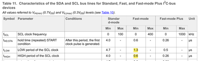

The I2C specification has no such requirement. Perhaps you are thinking of SPI. In I2C, the requirements for high/low periods on SCL are asymmetric.
Exact clock frequencies with I2C cannot be obtained because of how the chip waits for logic high when the pin is released. This takes a variable amount of time depending on the pullup resistor and capacitance on the line. There is no requirement that the clock frequency be exactly 400 kHz. You can increase the strength of the pullup, but an exact frequency will never be obtained here. Nor is it required.

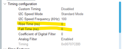

The clock frequency in scope plot is 400 kHz whereas the settings selected were for 100 kHz. This should be rectified. I assume the screenshot was taken at a different time.

I know, that UM10204 does not require them to be the same on and off timings and that they cannot be at 70% (ViH for receiver), where the timings you are referring to is the case with the pull-up current specified. I'm refering to the timing at the bottom, sub 10%. I have seen very few I2C hosts that does like this (yellow signal).
Not sure what you mean by that?
It looks like a pretty standard waveform to me:
The slow rise suggests that your pullup is a bit weak?
Be more specific. There's nothing wrong with the posted signal, except perhaps the pullup is a bit weak.
Thank's @Sebastian33 See if these setting options are different from what you tried.
We only have 3V3 slave devices and a 1V8 supplied STM32U5 as host, so STM ViL and ViH is not according to UM10204, but signal certainly passes the level as specified by AN4899.
