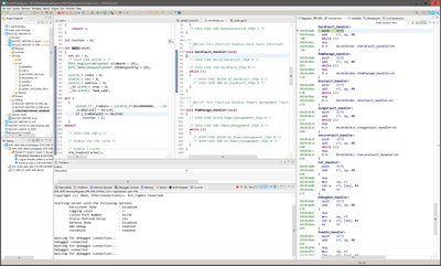

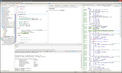

This is a debug session with debug level -Og:
This works fine!: I can write and read DTCM as secure and non-secure (0x30000000 vs. 0x20000000).
This is a debug session with none, as -O0:
This CRASHES: both addresses accessed result in a HardFault_Handler.
What is this?
I assume: the debugger has an effect on secure vs. non-secure access permission or system configuration done (by debugger instead of code).

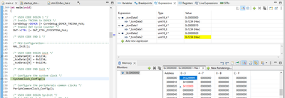

2025-01-04 12:23 AM - edited 2025-01-04 4:52 AM
Very interesting findings @tjaekel .
I can confirm, if I switch to -O2, then it does not crash into the HardFault when accessing the memory. However, this is far from over.

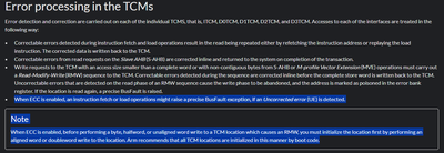

What is the conclusion? For my impression: TCMs have ECC, always on. On startup - it looks like - there is a mismatch between random RAM content and CRC. So, it needs a "clear" cycle, to initialize TCMs first before first use (to bring RAM content and ECC into "sync").
Anyway: an "interesting feature" (compared to H7 MCUs).
