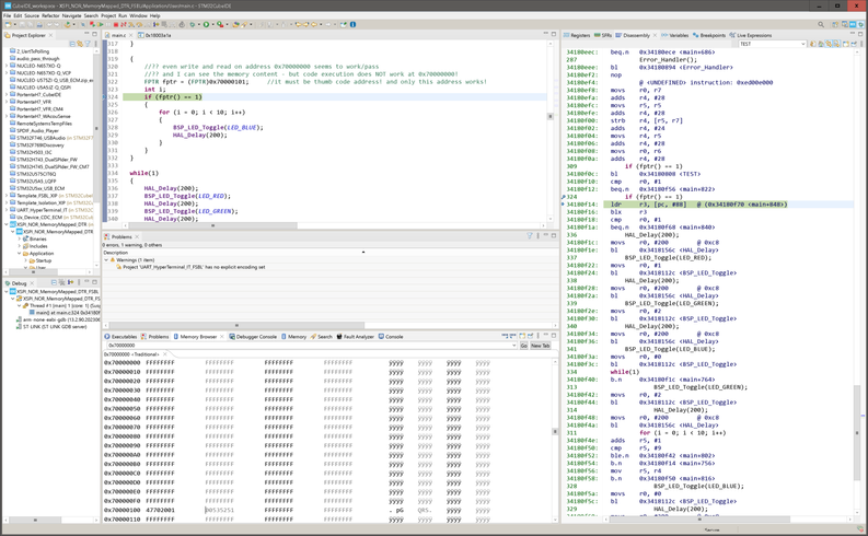

2025-01-03 4:28 PM
Here my debug session:
2025-01-04 12:59 AM - edited 2025-01-04 1:12 AM
Isn't it the place where the STM32N6 expects the binary "signature" using STM32_SigningTool_CLI.exe? And the offset shall actually be 0x400 (1kB)? Because that's the size of the signature. So it is maybe unreadable/unusable by design or something like that?
