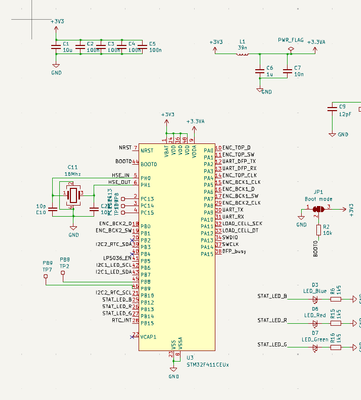

> STM32F411CEU custom board
Care to share your schematic? VDDA shorted to VDD? VSSA shorted to VSS? Appropriate bulk and decoupling capacitors present? VCAP cap present?

Hey thanks for the help!
Here is the schematics:
One mention is that the HSE is not present. About the VCAP, I just realized that I did not place it. Could this somehow influence the RCC?

2025-01-04 8:24 AM - edited 2025-01-04 8:25 AM
If VCAP is not present, the chip will not be able to run reliably, if at all. That is the issue. The capacitor on VCAP stabilizes/decouples the internal voltage rail. Without that, hard faults and other weirdness can be expected to occur, especially as the chip uses more power.
Getting started with STM32F4xxxx MCU hardware development - Application note
You can take a look at the design guide as well. But other than VCAP the schematic looks okay.
