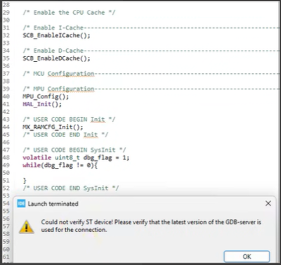

We are using the STM32N6 series MCU in our project and encountering issues during debugging. I’ve attached a screenshot of the error message we are seeing.
We followed the steps outlined in this guide:
https://community.st.com/t5/stm32-mcus/how-to-debug-stm32n6-using-stm32cubeide/ta-p/800547
However, the code cannot be debugged from external flash (in dev boot mode).
But, when we boot from flash (flash boot) and the debugger is not connected, the code runs as expected.
Also, debugging from RAM with FSB works, but debugging the App code from RAM fails and gives the same error.

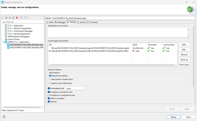

I understand that you lose connection with the debugger only in the App code in DEV_BOOT.
In the debugger configuration and as explained in the Knowledge Article, have you added the FSBL.elf and Appli.elf files to the Startup of your App's Debug Configuration?
In DEV_BOOT, after compiling and signing the binaries, and programming them into the external memory, the debug must be launched on the App project with the following Startup settings:
Often, the hang issue and the appearance of the STLink GDB Server message "Target is not responding, retrying" that you encounter occur when:
Let me know if it helps you?

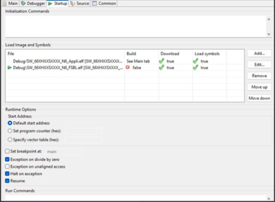

2025-06-16 12:47 AM
Hello @RomainR.
We are using custom hardware.
Yes we are using STM32CubeIDE and it is the last version of the IDE.
I’m configuring the settings as shown in the image, but I’m encountering an error. The application runs when booting from flash, but I’m unable to debug the application code.
