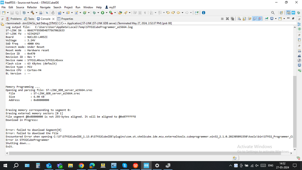

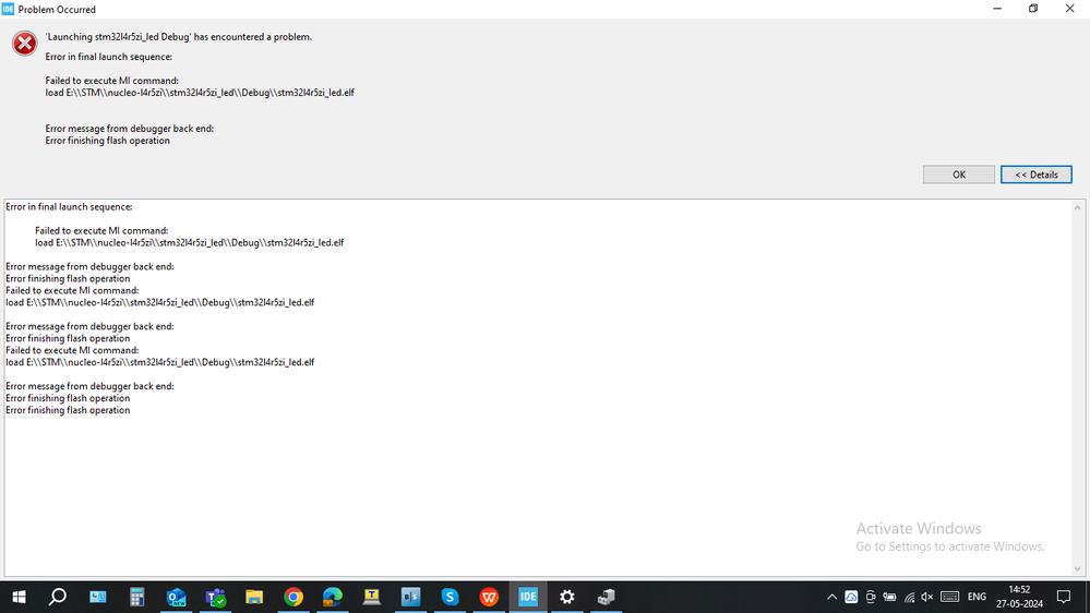

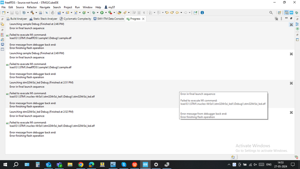

I'm using STM32L4 nucleo board, before it was working fine but suddenly it started giving error while flashing the code
I have attached screenshots please help me out. I don't know what is the issue exactly.Screenshot (581).pngScreenshot (582).pngScreenshot (583).png

Hello @ravikm258
Can you connect with STM32CubeProgrammer?
Check the Option bytes in CubeProgrammer. Try Connect under reset.
Check IDE debug settings also.

Hey @Imen.D,
Thank you for your response.
I found the solution for this issue, there was some issue with bootloader
I shorted Vdd and BOOT0 then I opened ST link Utility and did full chip erase after that I flashed the code and it's working fine now.
