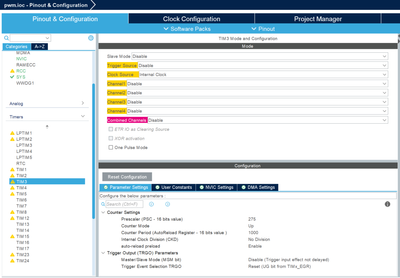

I have created .ioc project for STM32H735, where I am doing below things,
1. Generating timer delay for 1mS via TIM3, in interrupt of 1ms I am toggling the GPIO, below are configurations,

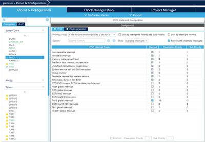

2. NVIC setting for TIM3 interrupt are as fallows,

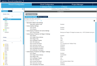

3. Cortex M7 configurations are as fallows,
With this configuration I am not getting output i.e. GPIO is not toggling after 1mS.
Request you please look into this where I am missing confutations.
