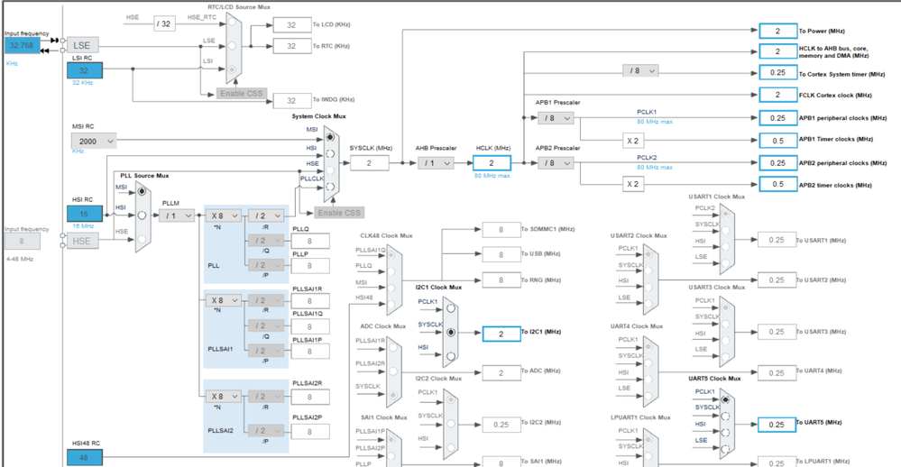

I have also attached my clock configuration as follows.
Appreciate any advise on what I am doing wrong. Thank you.
2024-09-20 1:11 AM
Solved this by adjusting clock to not use MSI, though this is not an optimal solution as i would prefer a lower clock speed configuration for my usage. Will try to see how i can modify the code to work with MSI clock configuration.

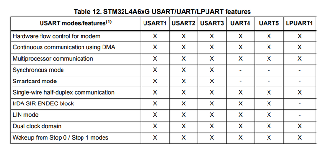

while(__HAL_UART_GET_FLAG(&UartHandle, USART_ISR_REACK) == RESET)In the datasheet, UART 5 is able to wake stop1, so i believe that it should be possible
