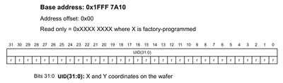

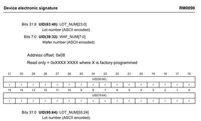

I've not got the data sheet for the F4 to hand, but the one for the G4 shows that the registers holding the device's electronic signature hold:
Bits 31:0 UID[31:0]: X and Y coordinates on the wafer
Bits 31:8 UID[63:40]: LOT_NUM[23:0] Lot number (ASCII encoded)
Bits 7:0 UID[39:32]: WAF_NUM[7:0] Wafer number (8-bit unsigned number)
Bits 31:0 UID[95:64]: LOT_NUM[55:24] Lot number (ASCII encoded)
From that, it would appear that common sequences for devices from the same batch would be likely.
