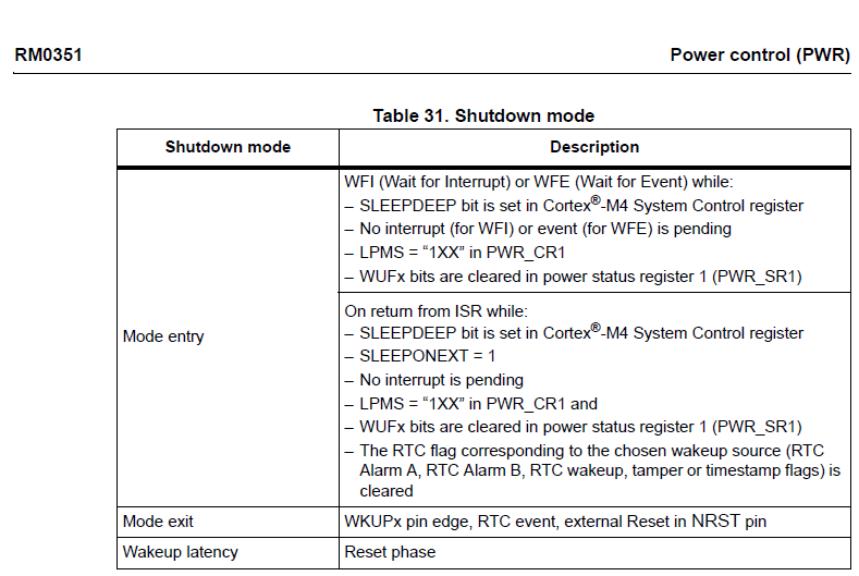

Just before you put device in shutdown mode there are some bits must cleared in Power status clear register (PWR_SCR) from all wakeup sources.
Relevant HAL functions do not clear theese bits automaticaly
You can clear theese bits by calling __HAL_PWR_CLEAR_FLAG(..) macro

The PWR_SR1 doesn't work in shutdown mode, this means that it's always 0. I suggest you to debug your code using the Standby mode in order to look at the SR1 and try to understand which sources is wakeing up your device.
To solve a problem similiar to yours, I cleared the WUP source in both standby and shutdown mode writing 0x11F in the PWR_SCR register as the last instruction before entering the shutdown state.
I think that after setting up the PWR register to wake on some source the processor starts detecting them immediatly, it doesn't wait for the WFE/WFI instruction. For this reason if something happen between your set up and the WFI/WFE call, the processor wakes up immediatly. I haven't find this behaviour described in the reference manual, is just some guess I made.
