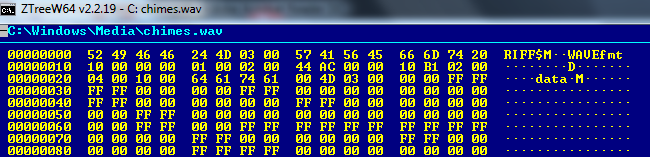

I think the length field in your case is bogus. The WAVE format can represent a large number of audio formats and rates, you have to decompose the headers to understand the data representation that follows.

To create the header you'd need to know some things about the type of PCM data you are describing, including the sample rate, width, channels, byte rates, etc.
Unless the form of the data matches that expected by the output code it is likely to sound awful. You can't just slap a header on it. You could use some basic File IO routines to create .WAV files, ie fopen/fclose/fseek/fread/fwrite2016-03-14 6:01 AM

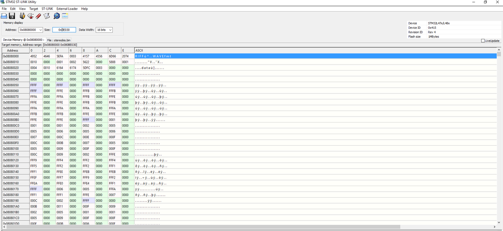

in fact, the RIFF header was lower in my wav files so with notepad++ I deleted the first rows as far as I found the ''RIFF''.#include <

I got these fields:
2016-03-15 9:07 AM
I managed to load two wav files without sizzle other than that available in the demo. For this four conditions are necessary (using the ST-Link utility and demo program provides ST). 1 ==> It is necessary that the file size is < or = to 500kb for a repeat loop. 2 ==> It is essential that the downloaded .wav file begins with header RIFF.WAVE nothing even erasing the first lines you can hear the sound but will be accompanied by a horrible sizzling ... 3 ==> It is imperative in line 53 of the demo program to put the size (a little less) of the file that we will inject into the flash.#define AUDIO_FILE_SIZE (133*1024) Ex: My file does 137Ko so I put 133 to avoid any noise because the file is played in loop.
4 ==> Comment out the line 97 or inform the beginning of entete RIFF your file.
